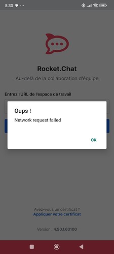

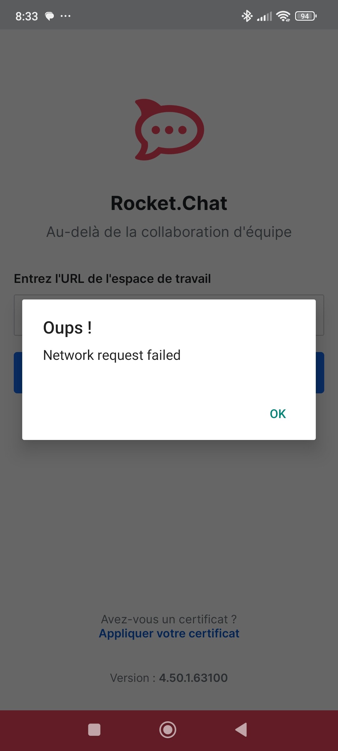

Network request failed on mobile app for both iOS and Android
Hello,
I am experiencing an issue with Rocket.Chat mobile app, both on iOS and Android. When trying to access our Rocket.Chat server through the mobile app, I consistently receive the error message “Network request failed.” The issue occurs regardless of the mobile platform.
Here’s what I have tested:
  • The Rocket.Chat server is accessible without any issues via mobile web browsers and desktop apps.
  • The server works fine in browsers, but the mobile app is unable to connect.
Has anyone encountered a similar issue or can suggest a solution?
Thank you!
