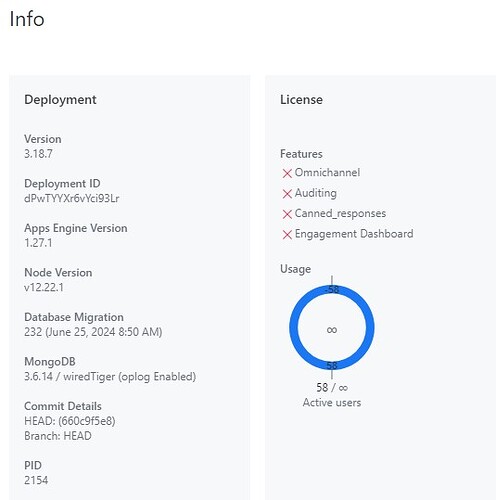

I’m afraid that 3.18.7 is EOL and out of support since Feb 2022
https://docs.rocket.chat/docs/support-prerequisites-and-version-durability
Please upgrade.
Note your issue is likely due to using IP addresses and host/domain names. They need to resolve correctly.

i am using rocketchat snap installation behind fire wall used locally and accessed via static ip also using port forwarding setting e.g http://1.1.1.1:3000 .
That is likely where your problems lie.
You can’t update your rocket if your server is not able to communicate with the world and it sounds like you have isolated it.
First, make sure your Ubuntu server can properly access the internet.
Do not try and upgrade form 3.x to 6.x - use tracks and upgrade a bit at a time, use lots of backups, and test between upgrades.
https://docs.rocket.chat/docs/deploy-with-snaps
You should also use a reverse proxy rather than a port forward - it is FAR more secure. Do not expose 3000 to the outside world.
Please read the docs on how to do this. If nothing else run a nginx proxy server on the ubuntu server.
