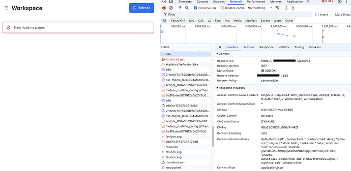

Can not load workspace information. Has anyone else had this problem? How did I fix it?

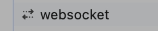

Check the websocket. That is key.
Disable cloudflare & test.
If you search here you’ll find several instances where it is not properly set up and will cause issues.

This is the setting you need to check in the dev tools:
Might need to look at your compose/.env too.

I checked and found that the domain name matches that I set. But I checked rocketchat container log, I found this log when I open admin information page.
{"log":"[2025-10-07T04:22:44.453Z] WARN xxxxxxxxxxxxx/BROKER: Service '$node.list' is not available.\n","stream":"stderr","time":"2025-10-07T04:22:44.453919727Z"}
